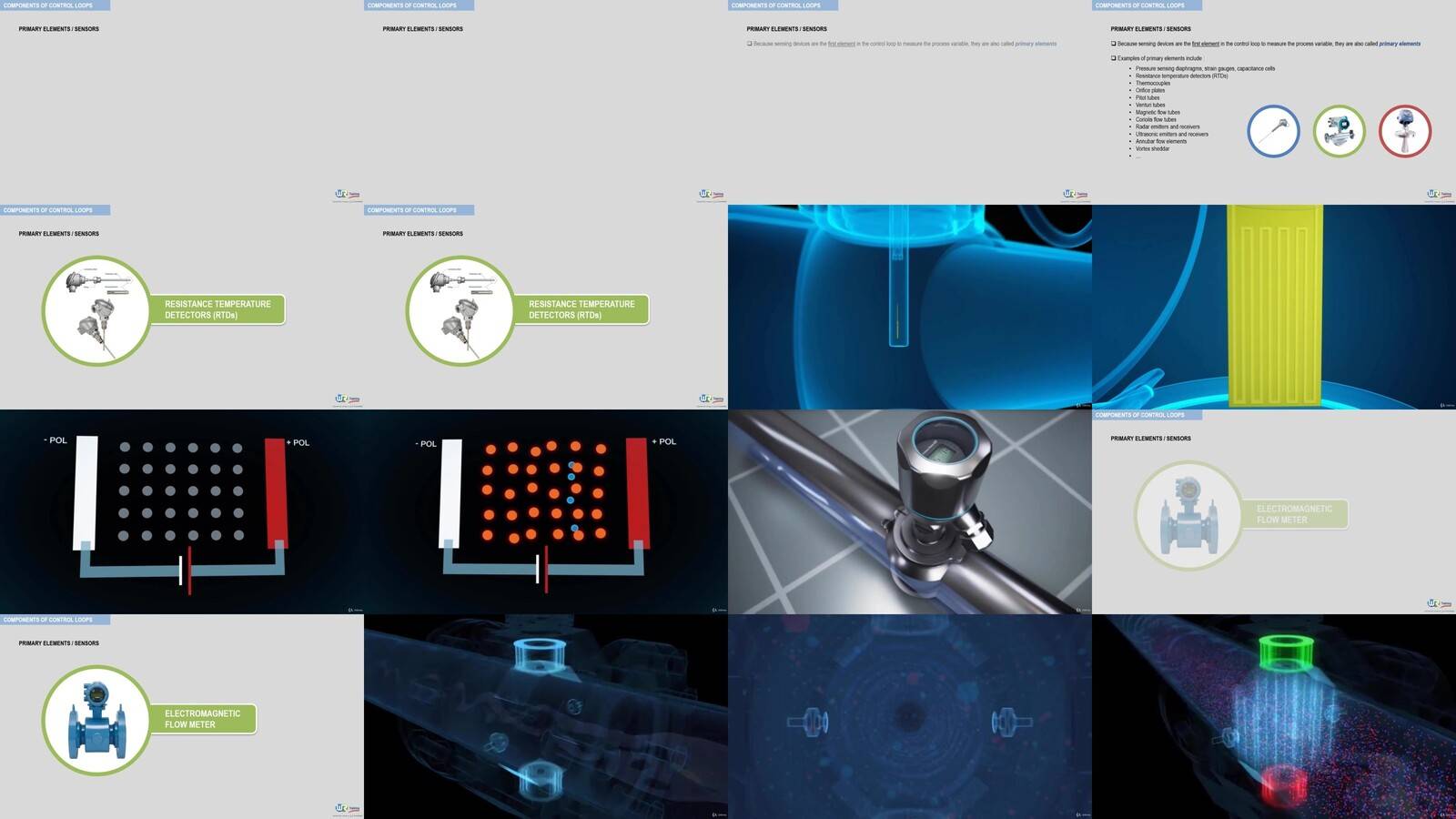

Understand through extensive 3D animation the techniques and methods used in process industries to measure temperature, pressure, flow and level

The course includes extensive graphics, cut sections, process schemes and 3D animations to give you a virtual practical exposure on process control and instrumentation.
