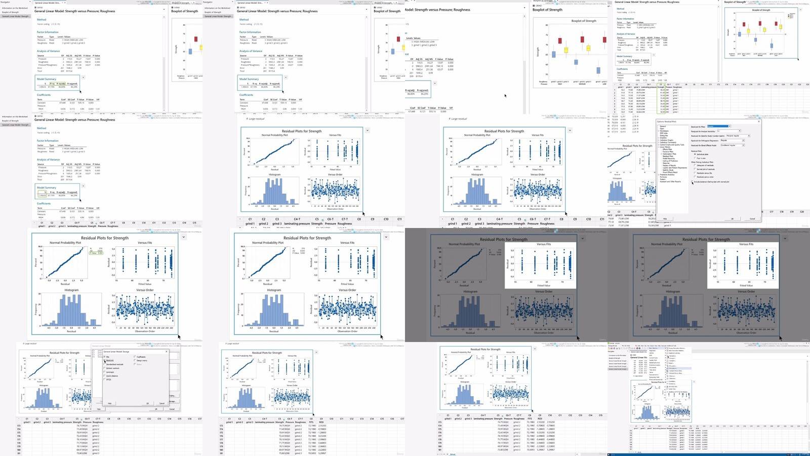

Duration: 1h 1m | .MP4 1280x720, 30 fps(r) | AAC, 44100 Hz, 2ch | 431 MB

In this training unit,students learn how to apply theTwo-Way Analysis of Variance (ANOVA)to evaluate the influence of two categorical factors on a continuous response variable, using a realistic industrial quality control scenario.
The case study is taken from thelamination process in skateboard deck productionat Smartboard Company, where the tensile shear strength of glued maple layers is the central performance indicator. The two experimental factors -laminating pressureandsurface roughness- are each examined at three levels, leading to 9 parameter combinations and 270 measured values.
Students follow a structured learning process:
Data Preparation: Importing raw test data, stacking column blocks, assigning factor names, and formatting the response variable.
Visual Analysis: Usingboxplotsandmain effects plotsto explore initial trends and identify possible interaction effects between predictors.
Statistical Modeling: Performing a two-way ANOVA with interaction terms using the General Linear Model (GLM), interpretingp-values, and understanding the logic behindmain effectsandinteraction effects.
Model Diagnostics: Evaluating model quality with R-squared and residual analysis; confirming the normal distribution of residuals with a 4-in-1 plot and the Anderson-Darling test.
Post-hoc Testing: Applying theTukey significance testto identify which specific combinations of pressure and roughness lead to significantly different strength outcomes.
Business Interpretation: Drawing conclusions about which parameter settings deliver the most stable and high tensile shear strength, and recommending optimized production configurations based on statistical evidence.
